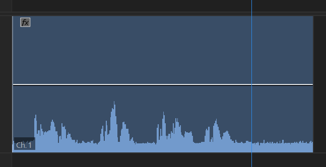

I have contacted online support for DJI today and have been able to upload a sound file.  The person on the other end says he can't really hear the hiss.  I cannot believe that he couldn't hear it as it is glaringly obvious to me.  I Can't get the sound to upload on this forum as above but I did the next best thing took it into Premier Pro and screen shot the wave form.  See below.  I also used a different mic and got the same result.  I also used the Rode Mic on a different camera and there is NO sound issues at all.  Here's the thing then, I think this low hiss is the mic picking up the gimbal motors (as the fan turns off auto)  If this is the case why are DJI pairing the Osmo and Rode mic together?  The Osmo clearly is not set up for, and never will be able to cope with, high quality sound.  DJI should state this before they sell microphones for their Osmo.
Does this sound a fair comment?  What should I do next please?

Zap Posted at 2018-6-14 08:26
We sincerely apologize for the inconvenience that you're having right now. We will raise this up to our engineers to look for a solution for your concern. We will keep you updated. Your patience will be much appreciated.
